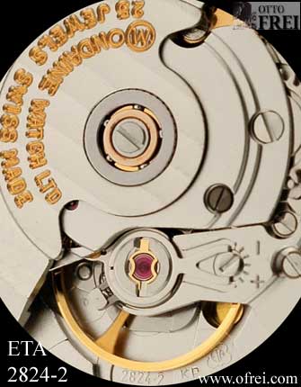

ETA 2824-2 movement is equiped with a wheel gear for hand-winding. It is normal.
>同是2824-2 的浪琴...一天誤差竟13秒左右< ± 10 seconds/day is normal for non-COSC grade Swiss made watches. If it cannot be adjusted to within this limit, replace the balance wheel with a COSC grade if you know how to fix a watch: http://www.tztoolshop.com/images/eta2824-2modaine1.jpg |
